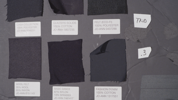

Now let’s try the TrueND filters with the RED Epic:
Above: Epic, TrueND .30.

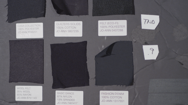

Above: Epic, TrueND .90.

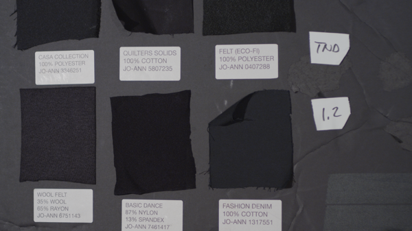

Above: Epic, TrueND 1.2.

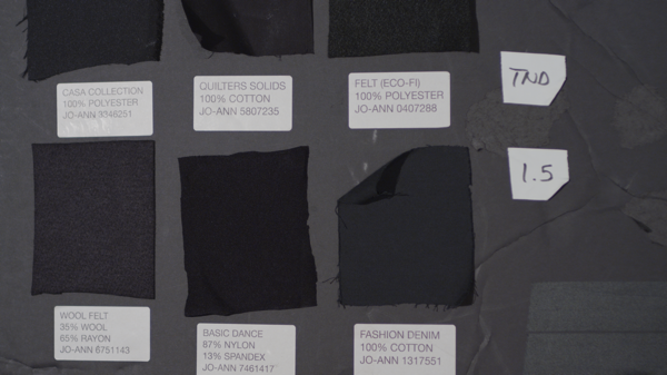

Above: Epic, TrueND 1.5.

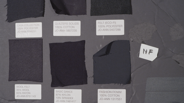

Above: And, once again, Epic with no filter at all.
I think I can let those results speak for themselves. This one kind of filter works on both kinds of cameras: those that require IRNDs (Arri Alexa, EX1/EX3, etc.) and those that require hot mirrors (REDs). That’s quite an achievement.

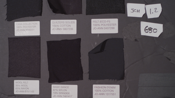

There’s one thing that bothers me, though. I shot a test with a very old filter that Schneider gave me years ago, the TrueCut 680. This filter is a dichroic filter that is supposed to cut the spectrum like a knife above 680nm, which is just short of the Rec 709 color spec limit of 700nm. It was never mass manufactured because the dichroic coating was so thick that it had a tendency to change color: if you looked directly through it the filter was perfectly neutral, but turn it 45 degrees away from you and the whole filter shifts toward cyan. This isn’t a problem on a long lens, but on a wide lens, where light from the edges of the frame passes through the filter at an extreme angle, this filter has the unfortunate effect of adding a cyan vignette to the edges of the frame. Still, it’s a great reference filter. Here it is with the Schneider ND 1.2, with that filter’s magenta cast removed:
The TrueND matches the Schneider TrueCut 680, which is both good and bad. It’s good because it cleans up IR/far red really, really well, but bad because it may clean up too much. You still need to pass a little bit of far red to make skin tone come to life, and I worry that this filter may cut too much far red and make skin look a little dull.
