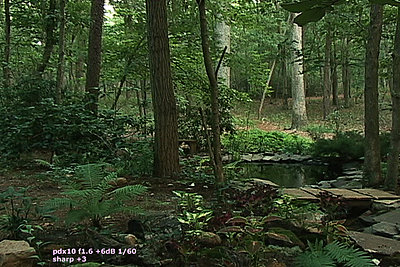

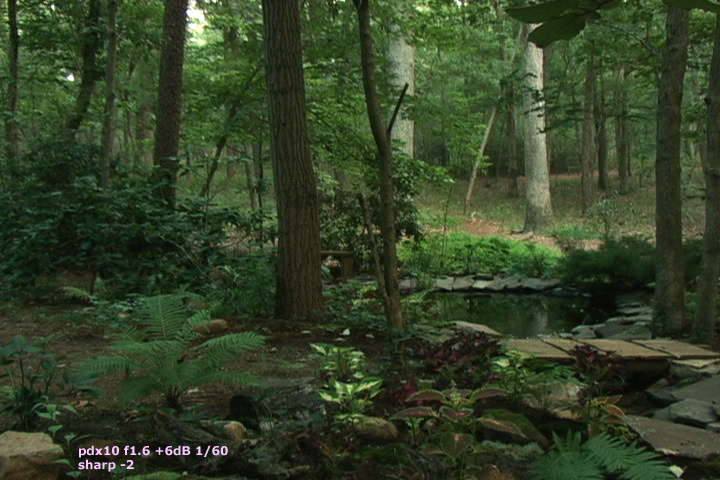

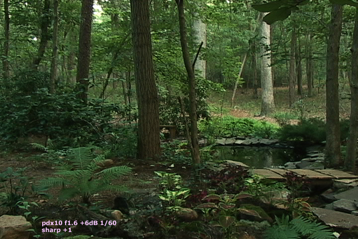

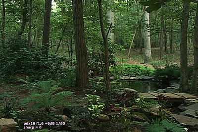

I guess it depends on your personal taste and also your subject matter. Personally I always disliked the oversharpened default on the PDX-10 that left hard outlines around objects. I don't use mine anymore (it's on "vacation" with a friend in Greece now :-)
But several years ago I shot this series of tests using a scene with lots of fine detail. I think my favorite would be sharpness set at -2. But like I said, it depends on your personal taste.

Excellent comparison material there, thanks for the info. I agree with what you're saying but these shots do confirm even more that this is not a simple sharpening filter.
I think what would probably be the case here is that there is a slight sharpening filter applied to the raw ccd data before it is then downscaled to the normal video resolution (because I believe the camera downscales it from a resolution that's quite a bit higher).

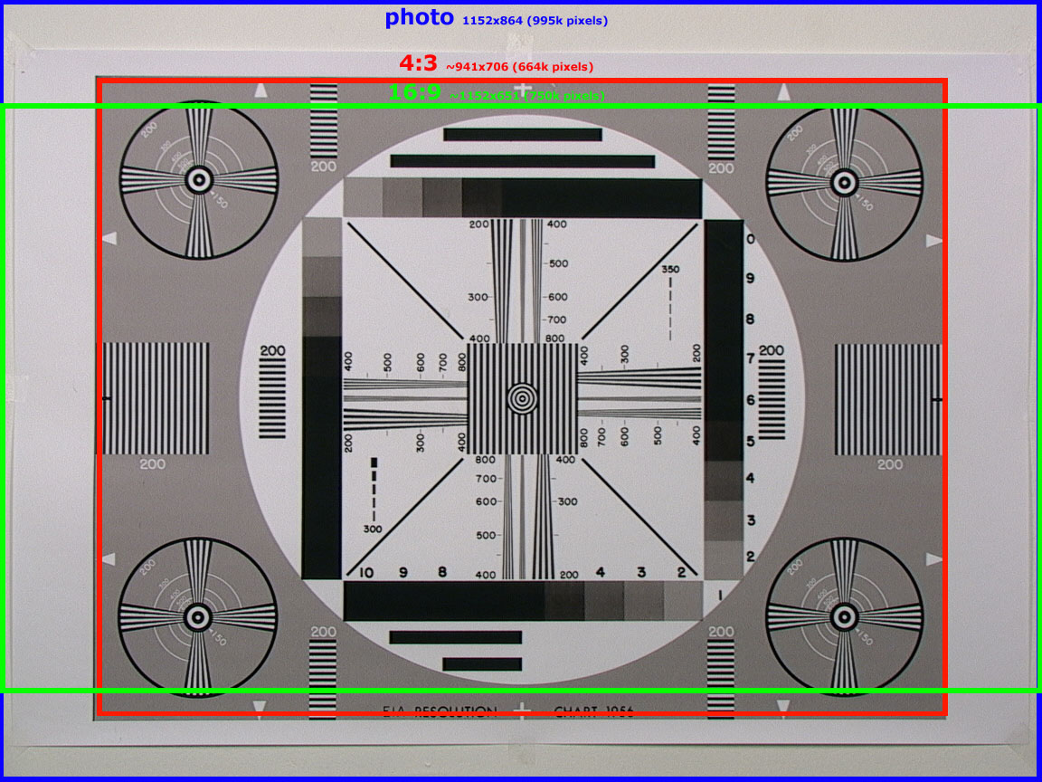

Yes, the CCD's are 1152x864. I did the following test by framing a shot to fill the frame in photo mode, then switched to 4:3 and 16:9 video in order to learn how it crops the image (note: I was using the NTSC version, so yours will be a little different).
The PDX-10 is a really nice little camera, and a lot of bang for the buck. But the tiny (1/5") chips have their limitations. Even though they are relatively high resolution, the small size seems to give a rather coarse quality to the full res stills.
