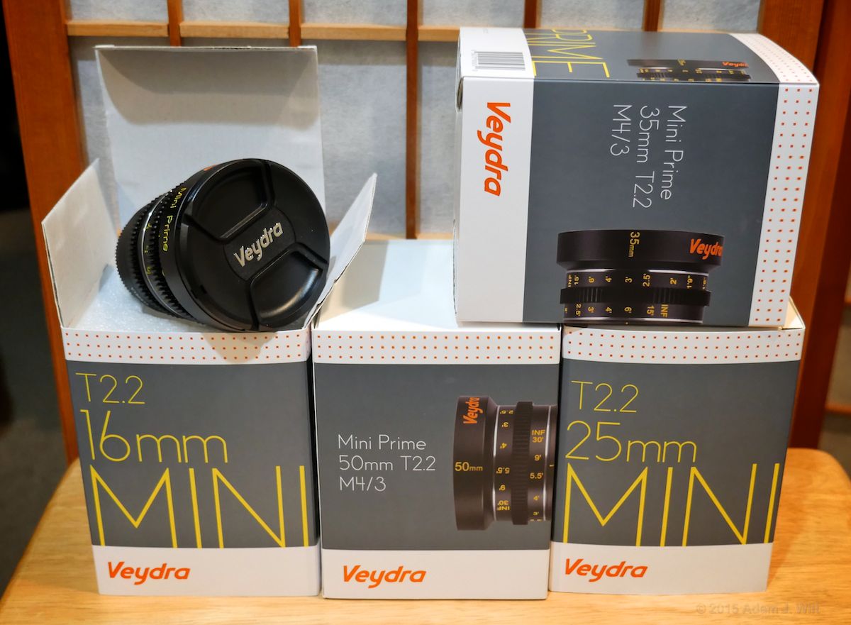

This past week, the first four-lens sets of Veydra Mini Primes for MFT cameras started shipping to Kickstarter backers, resellers Hot Rod Cameras and Duclos Lenses, and rental house LensProToGo (page loads scrolled down; scroll up to see rental info). My set arrived on Wednesday:
Four Veydras fresh off the boat

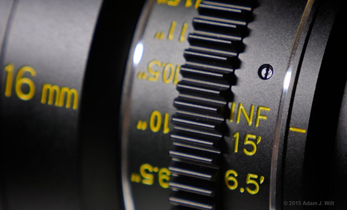

Focus calibration? I aimed the lenses at a ridgeline about 7 miles away and focused with maximum onscreen magnification.
The 16mm fell just a bit short of ∞, by about 1/4 the height of the characters in the distance marking. In other words, instead of the index mark falling in the exact middle of the “INF” engraving, it fell in the middle of the lower half.
Infinity on the 16mm
This being a Veydra, I can loosen the three setscrews securing the distance scale and adjust it to perfection if I so desire, but I’ll play with it a bit more at a variety of distances before I disturb the factory setting.

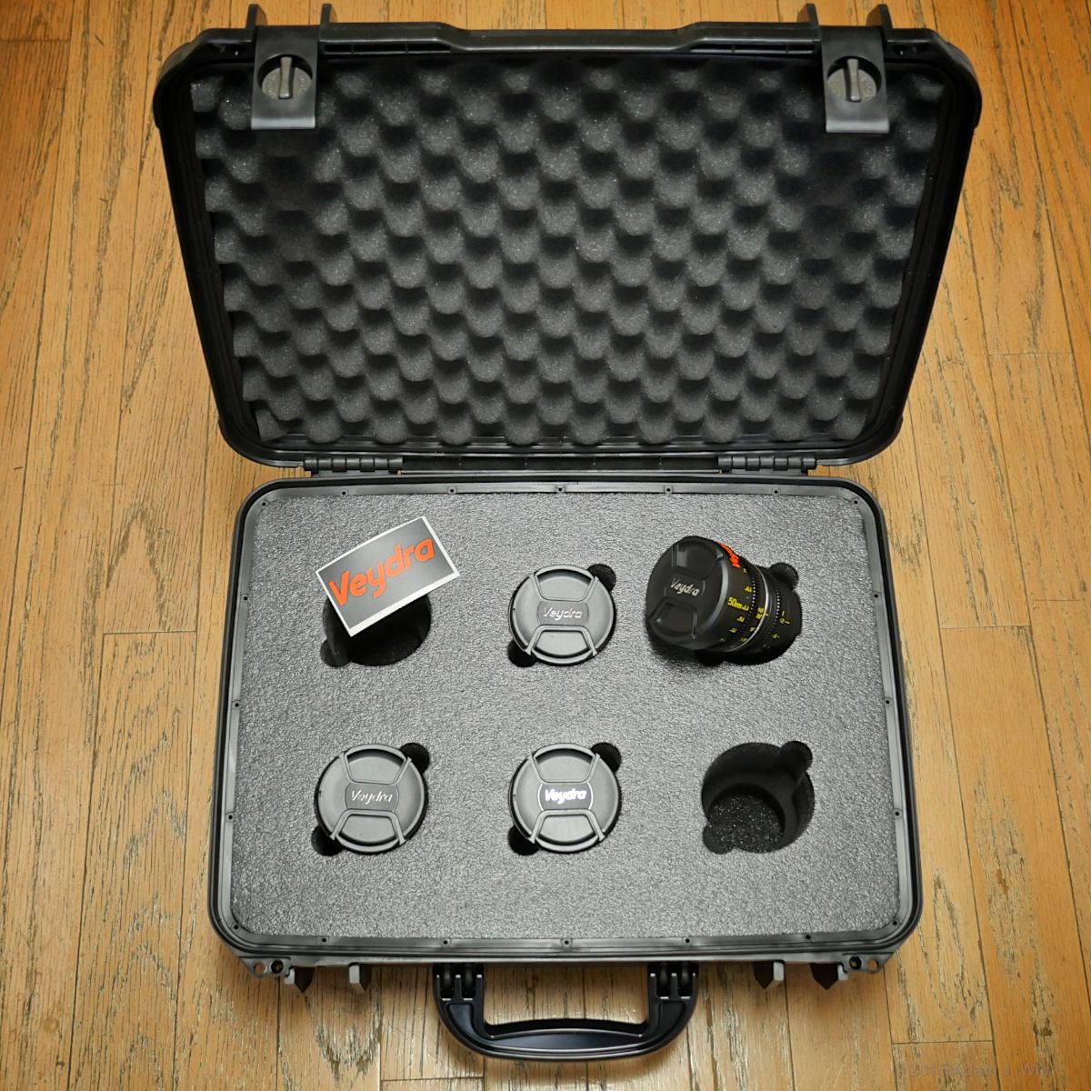

Veydra's six-lens case
Veydra’s six-lens case
The case, currently $199 from Veydra, is a Seahorse SE-720 waterproof case with custom-cut foam inserts for six lenses: the four lenses currently shipping, a 12mm T2.2 that’s supposed to ship this summer, and a newly announced 85mm T2.2 that’s due at the end of the year.
The case comes with a red Veydra sticker you can apply to the outside if you wish, or you can leave the case unmarked as you see fit (not that it makes much of a difference from a security standpoint; even unlabeled cases like this are as irresistible to thieves as catnip is to cats. At least “Veydra” gets past airport cops more easily than “RED BOMB EVF” or “RED WEAPON” will, grin).
