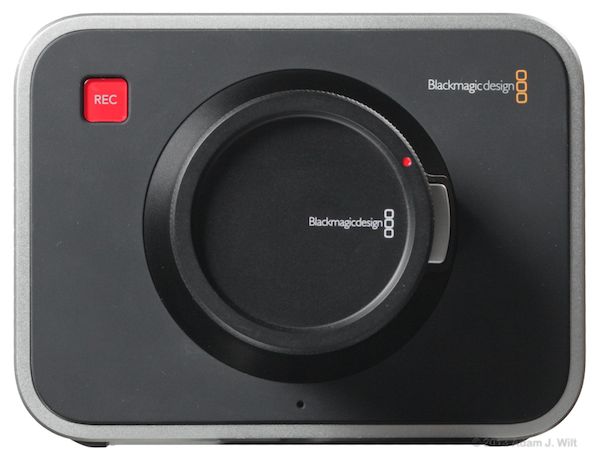

From the front, the Cine Cam is a rounded rectangle with a lens mount in the center. It’s about 6.5 inches wide, 5 inches tall, and 4.5 inches long (166mm x 126mm x 114mm). The frame is a silvery, matte magnesium alloy, while the front surface is a grippy rubber surface surrounding the black metal lens mount. A red REC button in the upper left corner, a silver lens-release button, the Blackmagic design logo, and a tiny hole below the lens mount for the built-in mono microphone, are the only distinguishing features.

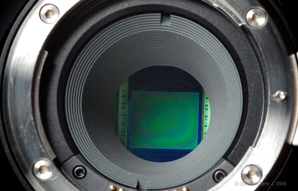

The BCC's sensor
The 15.81mm x 8.88mm CMOS sensor – about 36% smaller than Super35mm / APS-C, some 10% smaller than a four-thirds sensor, and roughly 25% larger than Super16mm – sits comfortably behind an anti-reflection baffle.

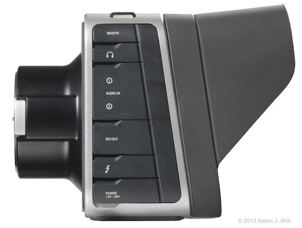

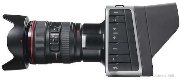

The left side view reveals the tapering wedge shape of the body. Hinged rubber covers shield the camera’s I/O connectors. A dark gray viewfinder shade is supplied with the camera; you can remove it if you so desire.

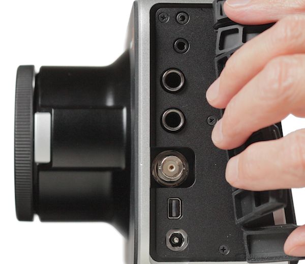

BCC connectors
A 2.5mm LANC connector allows remote start/stop, and focus / iris adjustments with compatible lenses (on the EF model, not the MFT model). My decades-old RM-95 refused to perform when plugged in, neither controlling the camera nor displaying anything on its LCD status panel.
There’s a standard 3.5mm stereo headphone jack. Dual 1/4″ phone jacks let you connect mic- or line-level inputs. A BNC provides a 10-bit, 4:2:2 HD-SDI output with embedded audio. A Thunderbolt port lets you connect the Cine Cam to a PC or Mac for monitoring using the supplied UltraScope software, or offboard uncompressed recording using Blackmagic’s Media Express software, also supplied.
Finally, a standard 5mm coax power connector accepts DV voltages from 12-30V. I had a universal wall-wart adapter which plugged right in (tip-positive, shell-negative, if you want to try this at home). The power feeds into a built-in, 90-minute battery, which may not sound like much, but the camera happily operates while external power is being connected or disconnected. You can move between external batteries, AC adapters, and the internal battery without glitching or dropping frames, so the built-in acts as a buffer or backup battery as much as a primary power source.

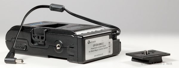

alternate battery
Blackmagic also sent along this Switronix PRO-X Powerbase 70 14.8V Li-ion battery, with an integrated mounting plate and a Switronix GP-DV-BMCC contact block adapter, and an AC adapter that charged the battery through an integral D-Tap connection.  This battery powers the Cine Cam for hours. How many hours? I don’t know, because I ran out of patience before this battery ran out of juice. Over at Planet5D they say it runs the camera for six hours, which I can well believe.

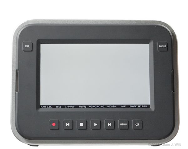

Note the status line at the bottom of the 5-inch, 800×480 touchscreen LCD:
  • RAW 2.5K – this shows either RAW (with the unfortunately incorrect 2.5K resolution figure, of which more will be said later on) or ProRes or DNxHD, as appropriate.
  • f5.2 – the current lens aperture (for lenses that communicate with the camera; EF model only).
  • 23.98fps – current frame rate.
  • Ready – recording status: Ready, REC, Disk Full, or No SSD.  When the SSD is getting full, REC and Disk Full will alternate. If frames are dropped, REC will flash. In playback mode, playback icons are shown.
  • 00:00:00:00 – running time for the current clip.
  • 800ASA – the current ISO rating.
  • 144º – shutter angle.
  • 5600K – color balance.
  • battery icon and level – 100%, 75%, 50%, 25%, or (presumably) 0%.
The touchscreen itself serves as a control point: tap it once to bring up a metadata panel (the “slate”), where you can set reel, scene, shot, and take numbers (the latter three can be set to auto-increment), enter a camera angle such as “wide” or “CU”, and enter a project name and keywords using an onscreen keyboard. Tap the screen twice to zoom in, pixel-for-pixel.
The screen taps need to be in the central part of the screen to register, in about the central 2/3. I also found the taps “backwards” to my taste; I often want to zoom in and out, and only rarely need the slate, yet I frequently found myself staring at the slate when I just wanted to check focus. Fortunately the slate won’t suddenly appear if you’re recording when you tap the screen, but still, I’d rather use a single tap – especially while recording – for focus checking.

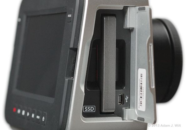

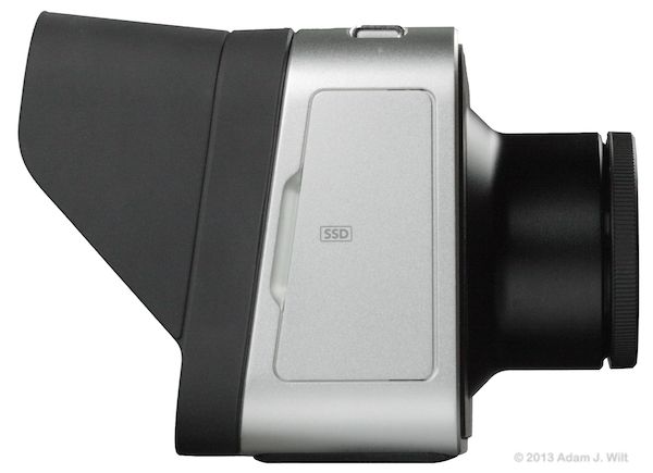

BCC right sideThe right side of the camera has the door to the SSD compartment.
BCC SSD door opened
It covers the slot for a standard 2.5″ SSD, and a USB port for firmware updating using Blackmagic’s Camera Utility software. The SSD simply slides in and is pressed into the SATA and power connectors; the friction of those connectors, and the closed door, are all that retain the SSD in place.

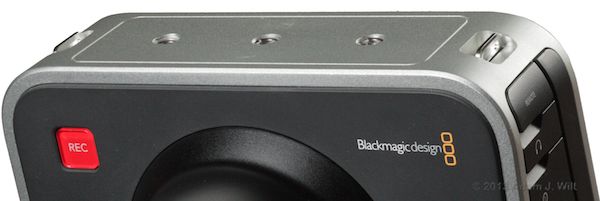

The top of the camera has three 1/4″ mounting points. The threads are hard-plated steel, not simply holes tapped in the softer alloy shell, so they’re robust and durable. Strap lugs on either side let you sling the Cine Cam ’round your neck, just like a tourist! An impressive-looking strap comes with the camera for that purpose.

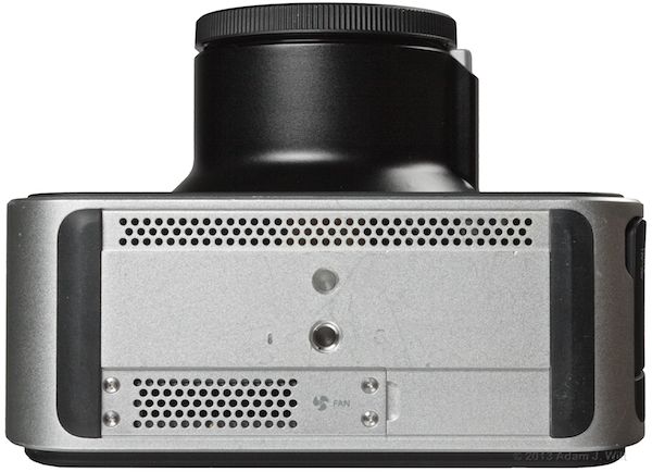

BCC base plate
The base of the camera has rubber feet at either side, a 1/4″ tripod socket, and an anti-rotation hole in front of it, and grilles for air movement. Air is drawn in through the wider front vent, and expelled by a constant-speed internal fan, to which the rear vent is affixed. This fan is user-replaceable should it fail. The fan makes a constant, low-level whooshing noise, which might be problematic for close-miking on a soundstage but is otherwise unobjectionable. The internal playback speaker also emits sound through these grilles.
Both grilles are recessed slightly so that air can get in even with the camera sitting on a flat surface or bolted to a tripod head. Do be careful putting the camera on a soft surface like a blanket or a rug, though, for fear of blocking airflow.

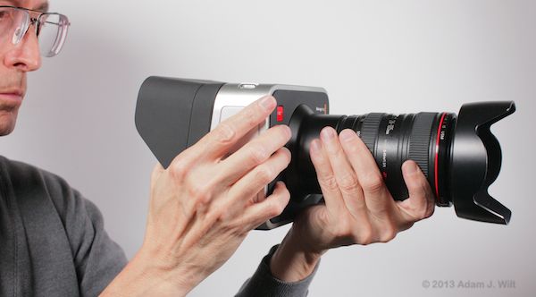

Handheld ops are a different story. The camera, sans glass and SSD, weighs in at about 3.75 lb (1.7 kg), and the trapezoidal profile, tapering towards the top, means it’ll slip out of your grasp instead of wedging itself more firmly into your hand. Still, with right hand in a death grip on the body, and left hand under the lens, somewhat wobbly handheld is possible, if not particularly enjoyable.
Handholding the BCC, without shade
Put the sunshade on, and you can no longer reach the front REC button while holding the camera, though the lip of the shade makes the camera easier to grasp.
Handholding the BCC with the shade

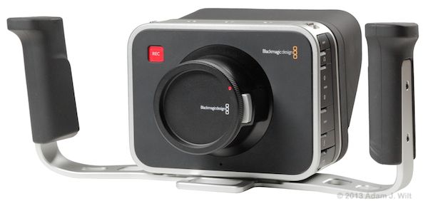

Blackmagic makes a stylish handle set for an additional $200:
BCC handles
The handles bolt into the bottom tripod socket, but don’t provide a socket of their own. A small foot sticks forwards, so the assembly is less likely to fall forward with a heavy lens attached.
The handles are perfectly comfortable, but their wide stance means you need both hands fully engaged at all times; you can’t let go with one hand without the camera sagging in a Dutch tilt of the sort that made German Expressionism famous. If you plan to start or stop recording, adjust focus, etc. while maintaining a level horizon, you’ll be wanting an assistant.
In short, the Cine Camera is a boon to purveyors of cages, baseplates, rigs, braces, shoulder stocks, and all manner of support kits, as it’s simply not designed with handheld in mind.
