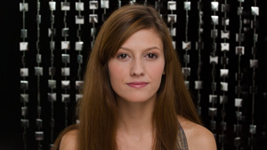

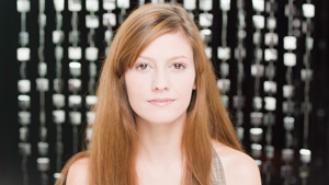

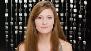

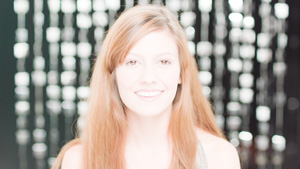

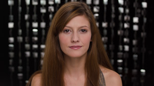

Director of Photography Geoff Boyle, FBKS, recently shot a test illustrating how Alexa handles flesh tone with increasing overexposure. He has graciously allowed me to reproduce his results. (The originals can be found here.)
Notice how color saturation doesn’t increase beyond the level seen in the “normal” exposure. The model’s face gets brighter, but it doesn’t get richer or redder or ruddy. If this was a watercolor painting then I’d say that each successive step of overexposure simply shows us more of the white paper underneath the paint.

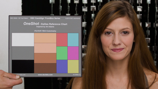

Disclaimer: I designed the DSC OneShot dailies grading chart that appears at the head of this article.
