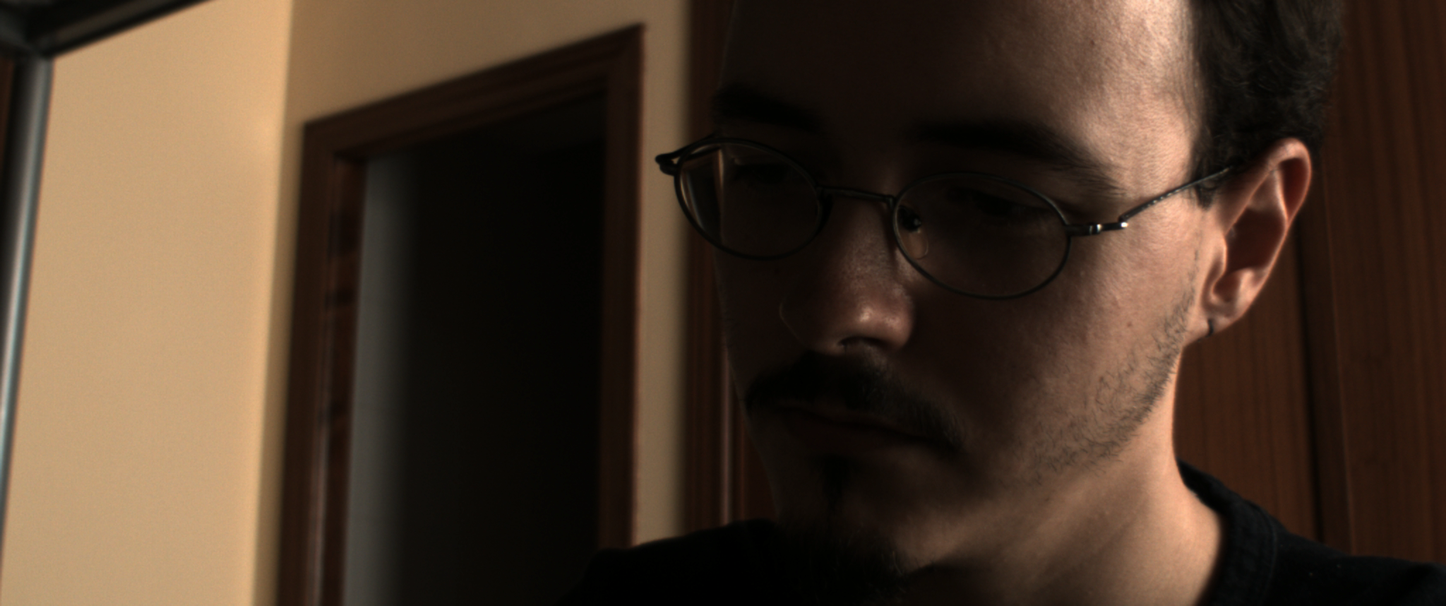

Here it is. Debayered and encoded using Lossless JPEG, captured and saved to PNG.
I'll probably be ordering the Elphel by next week, but I still have some questions, because with the Micron demo board I had bandwidth problems but I knew the clips were uncompressed and had a great quality. I'm not too sure about the Elphel because everything I've seen so far looks quite compressed and blurrier than the other option. My questions would be:
- Is OGG Theora better than MJPEG? Is it already available with the Elphel?
- I know Cineform codec would be great to get the best out of the Elphel but I also know it'd be expensive. Are there any plans to use lossless JPEG instead of the other two codecs with this camera?
- Does the ethernet interface offer enough bandwidth to shoot 2048x858 pixels at 24fps setting MJPEG codec to let's say 95%?
