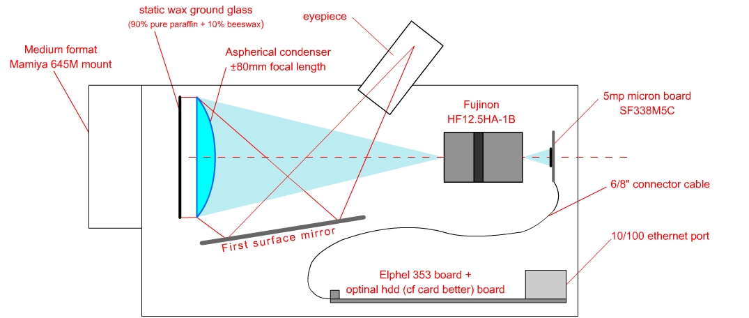

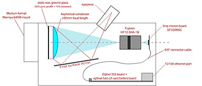

Oscar: cool project but I think that is very difficult to operate this way, too small tolerance and too small part for a diy project
take a look at what I'm planning to do ....with an adapter but a medium format one( the ground glass is big and can be used to preview the scene also)
Andrey:nice to see you back to the thread one question... is it possible with the new 5mp sensor binning 2x and have a true full size 1/2.5" 720p 60fps camera with the software we have?(I've tried the binning option with a link on the wiki maybe from polto or spectr the 353 and , like the camera link you have provided some ago "matteo.elphel.com" nothing happen)

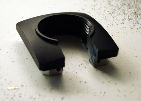

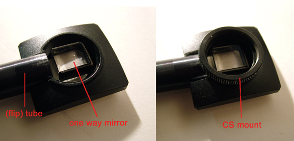

Matteo, I'm not sure how you want to have the mirror reflect the image from that angle without a perspective distortion, or am I missing something.
I have all the parts ready, and I'm about to drill a hole in the side of the Elphel. It'll be pretty hard to get everything inside a tube and focussed right, but I think it's doable.

Oscar: I think that the mirror is ok maybe it have to be checked the right angle ...try to put a picture 90° on your bathroom mirror and you'll see what I mean :-)

I've made some progress with the viewfinder. Making everything adjustable so I can focus everything right will be difficult, but you can see it should work out.
It seems that I have to cut a little bit from the side of the body too.
