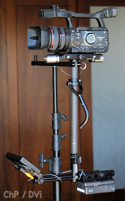

The Pilot with XH A1, balanced and ready to go.
Above: The Pilot with XH A1, balanced and ready to go.

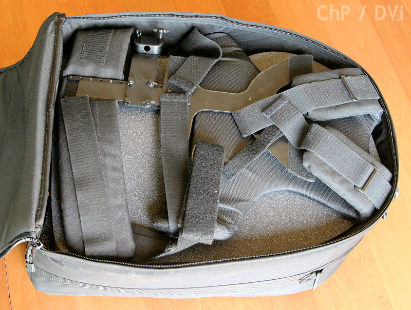

Pilot vest folds virtually flat.
Above: Pilot vest folds virtually flat.

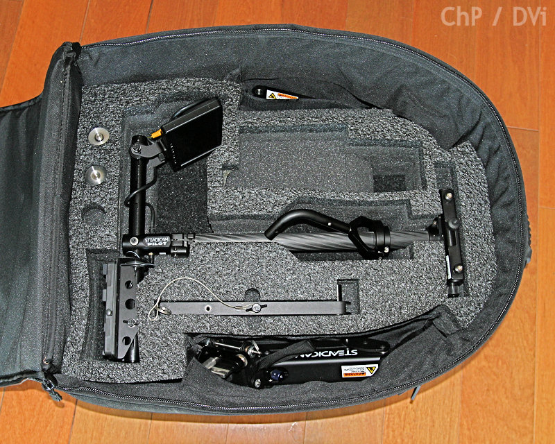

The Pilot comes in what is described as a “backpack,” but if forced to carry it around in such a mode, I’d be looking around for the nearest Sherpa. Opening the case reveals the vest, which is quite compactable as it is essentially a flat frame. Under this the components of the Pilot nestle in foamed compartments along with space for a Merlin if desired. One drawback is that these compartments are cut specifically enough that if the center post is extended or the lower components radically adjusted for a particular situation, the sled will not fit back into the case. If your shooting day required a lot of “company moves”, it would probably be easier to transport the components in their built mode rather than pack everything away as you might lose some of your settings. The arm has been designed to split into two sections via aircraft pin that cleverly doubles as part of the hinge mechanism, thus it travels in two separate compartments. There isn’t a dedicated slot for a charger or batteries, but the IDX package will fit into the zippered compartment on the top of the case. The Pilot can be ordered in IDX, Anton Bauer or AA battery pack versions, as well as a less expensive “Co-Pilot” version that only takes the AA batteries and has a smaller, 3.5 inch monitor.
 Storage for sled, arm.
Above: Storage for sled, arm.
My camera of choice was the Canon XH A1, which at 4 lbs is on the lighter side of cameras that the Pilot will support. I mounted the A1 to the supplied camera plate via included screw and provided “anti-rotation” pin that mates with the small hole fore of the standard thread common to most camcorders. Sadly the supplied pin was smaller than the pilot hole on my A1, and the camera still had the tendency to rotate slightly even when the camera screw was fully tightened. Some double-sided tape on the bottom of the camera would have improved things, or a thin layer of rubber. The plate then fastens to the top stage via 4 captive thumbscrews, which are spring-loaded and admittedly a bit funky in feel; I thought I had broken something when releasing them but they are just an unusual design. The setup appears reminiscent of the Glidecam 2000/4000 top stage but while those products rely on these screws to adjust fore/aft and side/side for balance purposes, on the Pilot they simply mount the plate to the camera platform. Many people like to use the rather nice Bogen quick release assembly (sold separately), which is very handy if you have a companion receiver on your tripod and will make switching between shooting modes a real breeze.
You will need a beefy light stand (I recommend the very nice Steadistand available from Tiffen) but the Pilot does include a docking bracket to store the rig between takes and aid with balancing. The sled is secured into the bracket via a sliding pin that I found sticky and difficult to guide quickly, something of a shame as this is a procedure that one will perform many times during a shoot. The docking bracket has two mounting holes, one of which will project the rig far enough away from the stand that continuous spin balancing is possible–a very thoughtful addition. Use common sense when balancing so that the stand doesn’t tip. Position the docking bracket over a leg of the stand and drape it with a sandbag or similar ballast (that hung-over PA passed out in the corner, for instance).
 All supplied weights up on the top stage. Also shows fore/aft and side/side controls, and detail of docking pin.
Above: All supplied weights up on the top stage. Also shows fore/aft and side/side controls, and detail of docking pin.
The Pilot ships with a selection of small steel weights, the same little guys that are used on the Merlin for counter-weighting. Here they can again be used to proportion the load between the top and bottom of the rig, but more interestingly, they can serve to increase the inertia of the rig. Since my camera was on the lighter side with no accessories onboard, I added all of the weights fore and aft on the camera stage. With a heavier camera or having more weights in my possession I would have added a few at the ends of the lower spar where their inertial effect is maximized. Although the weights themselves are fairly small, the effect they demonstrate is significant and this will aid in producing steadier shots. The rule of thumb here is that the further weights are positioned from the center of gravity of the system (which is just below the gimbal), the greater their influence on overall inertia. While this is a basic and easily proven concept, there are still some stabilizers out there that ignore this and have very slender profiles at the base. Such is their loss!
The Pilot has two knobs for adjusting fore-and-aft and side-to-side balance, something that will be a revelation to those who have previously used rigs that require loosening a series of screws, physically moving the camera plate, and re-tightening for each adjustment. With the Pilot you simply turn the knob and immediately judge the effect on balance with minimal fuss. Thus if you want to make on-the-fly adjustments (such as trimming for headroom or severe tilts), it is easy to do with one hand. I have heard from some owners of other systems that they have had to develop a whole series of techniques to fine-tune their top stages, such as the Nudge, the Coax and most frequently, the Don’t Bother, Just Suffer.
