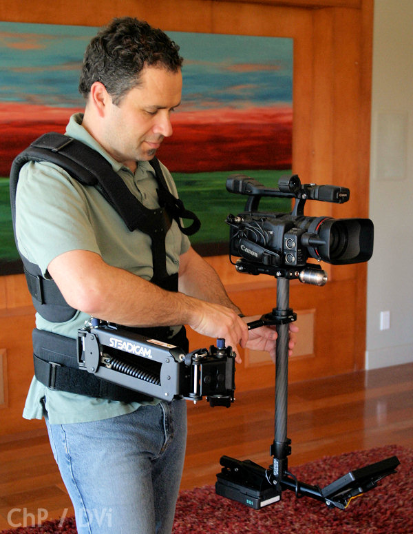

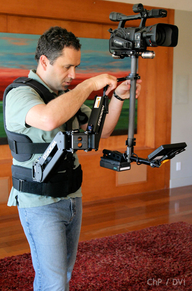

Image 3: The Pilot with A1, balanced and ready to go.

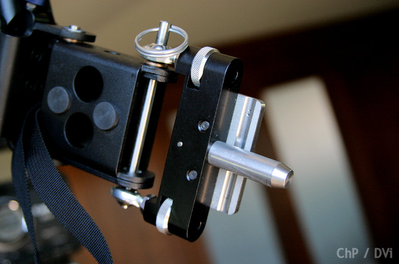

Image 4: All supplied weights up on the top stage. Also shows fore/aft and side/side controls, and detail of docking pin.

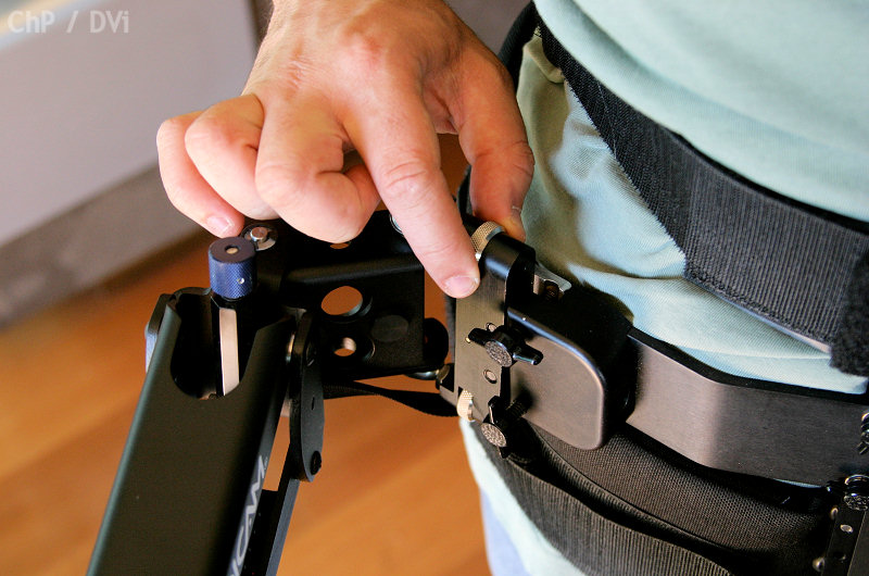

Image 5: Arm socket detail.

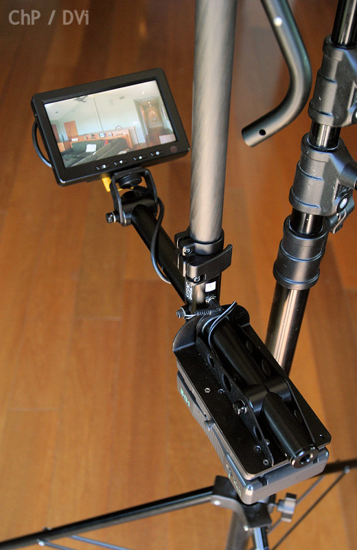

Image 6: Lower spar and monitor detail.

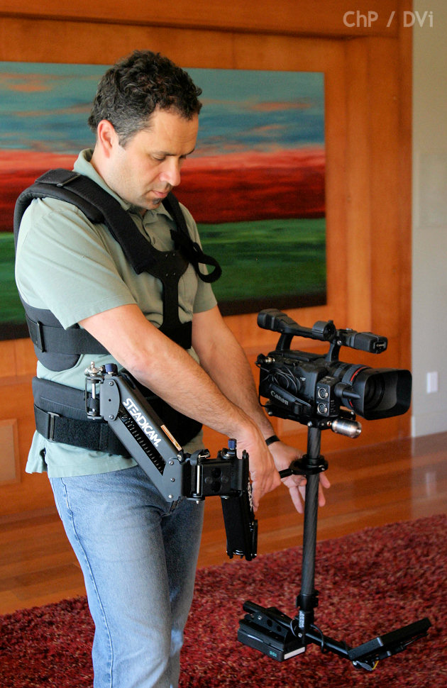

Image 8: Pilot in flight: Missionary Position.
Image 9: Pilot in flight: Don Juan.
Image 10: Boom range: full extension top height.
Image 11: Boom range: full extension boomed down.

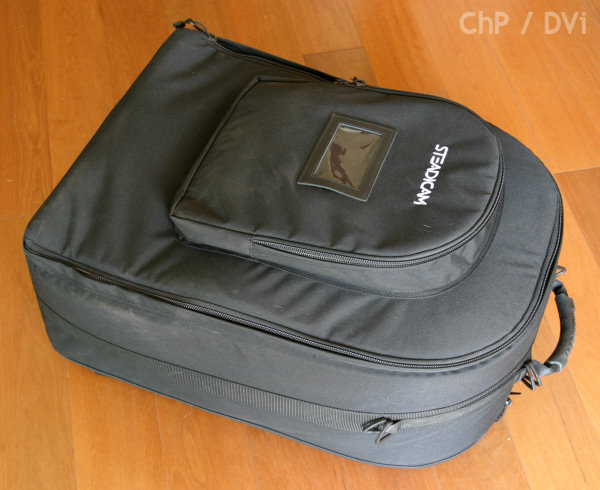

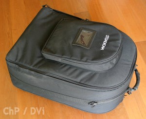

Image 12: Steadicam Pilot case.
