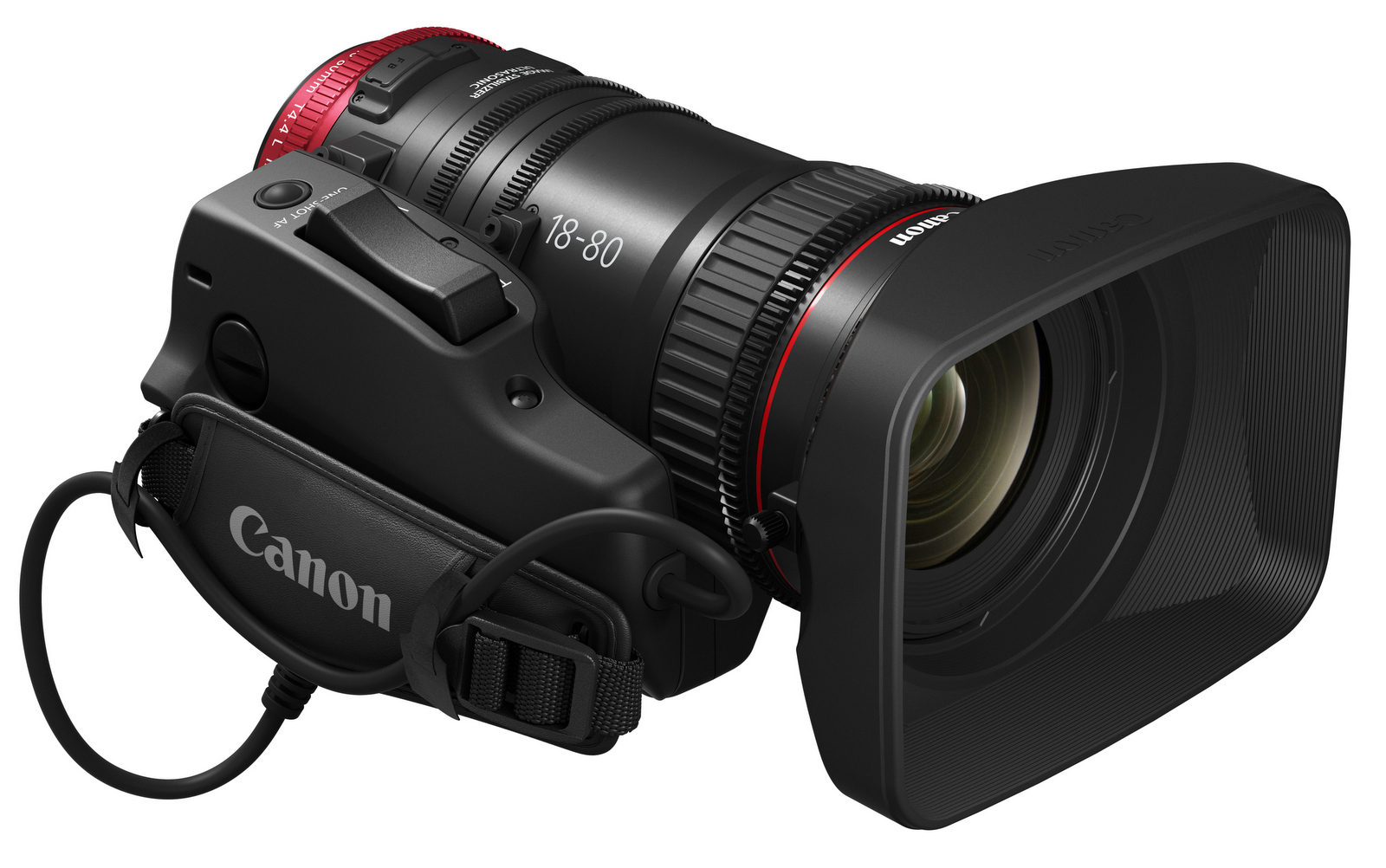

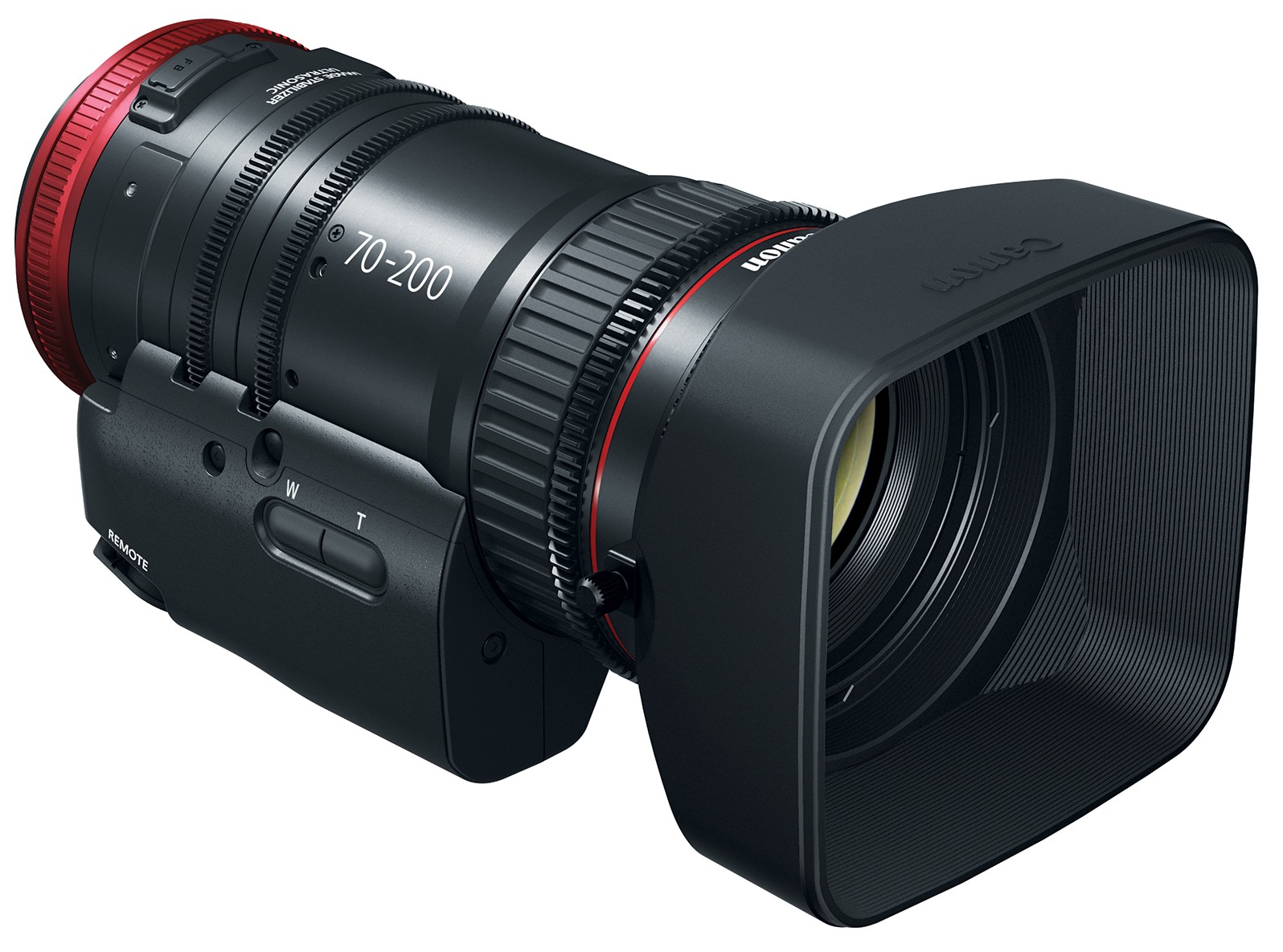

We begin with Compact Servo Zooms as they are the most affordable in the Canon cinema lens series. The 18-80mm wide zoom and 70-200mm telephoto zoom are matched in terms of size and length, allowing the focus, zoom and iris rings to be co-located. Both are constant aperture T4.4 with a 9-blade iris. They have switchable zoom motors. The optional ZSG-C10 grip adds a feathered zoom rocker and more. These are the only Canon cinema lenses with autofocus and image stabilization. Available in EF mount only.
Canon Compact Servo Zooms (S35 4K)
COMPACTSERVO18-082 E70-200-SLANT-FR-hiRes
COMPACT-SERVO 18-80mm T4.4 EF
(aka CN-E18-80mm T4.4 L IS KAS S)
(10.2016)    ⌀84/⌀77    MOD 0.5m    1.2kg    ~$5,300
CUSA product page  ·  Press Release  ·  User Manual
COMPACT-SERVO 70-200mm T4.4 EF
(aka CN-E70-200mm T4.4 L IS KAS S)
(4.2017)    ⌀84/⌀77    MOD 1.2m    1.25kg    ~$5,800

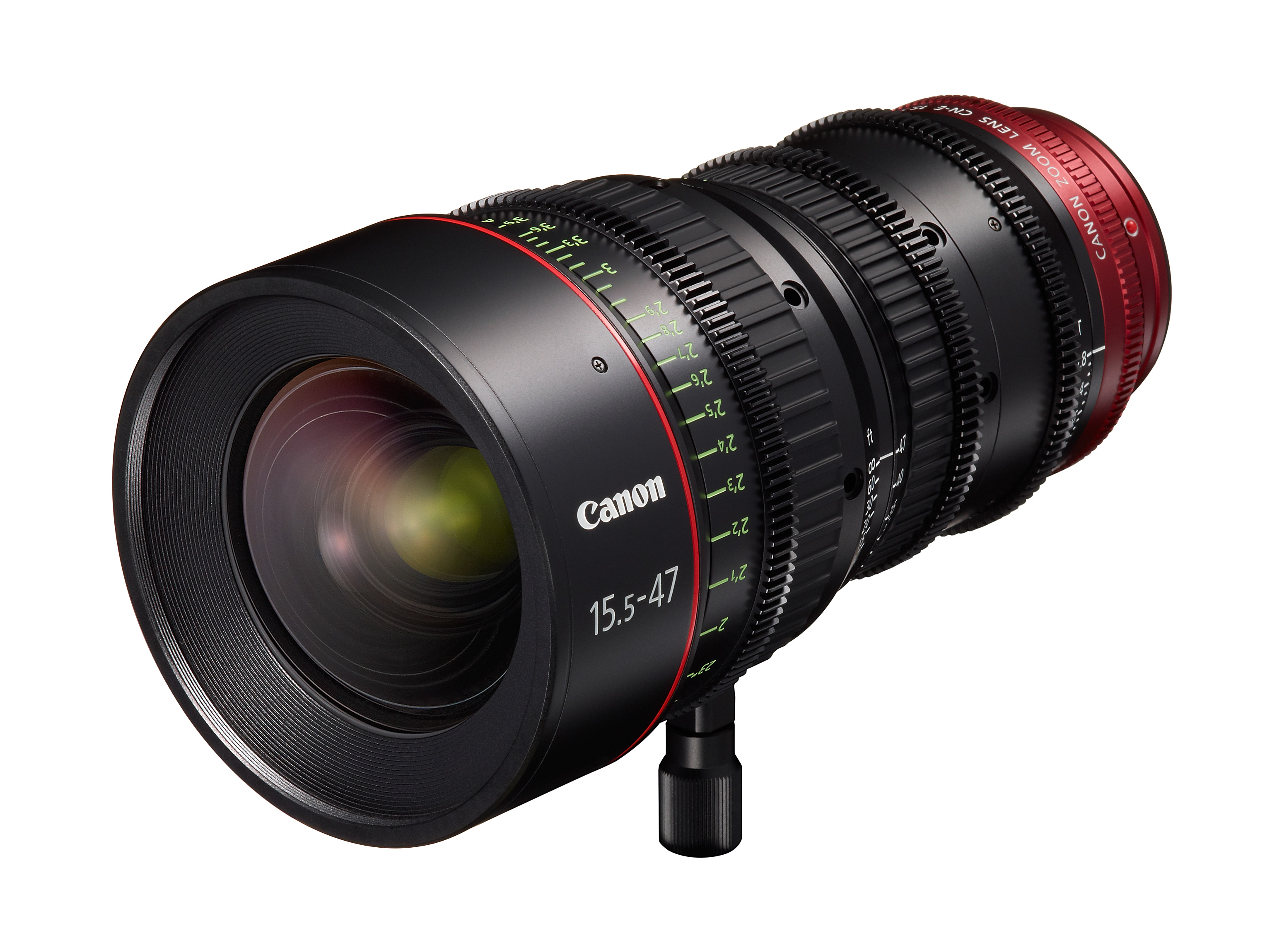

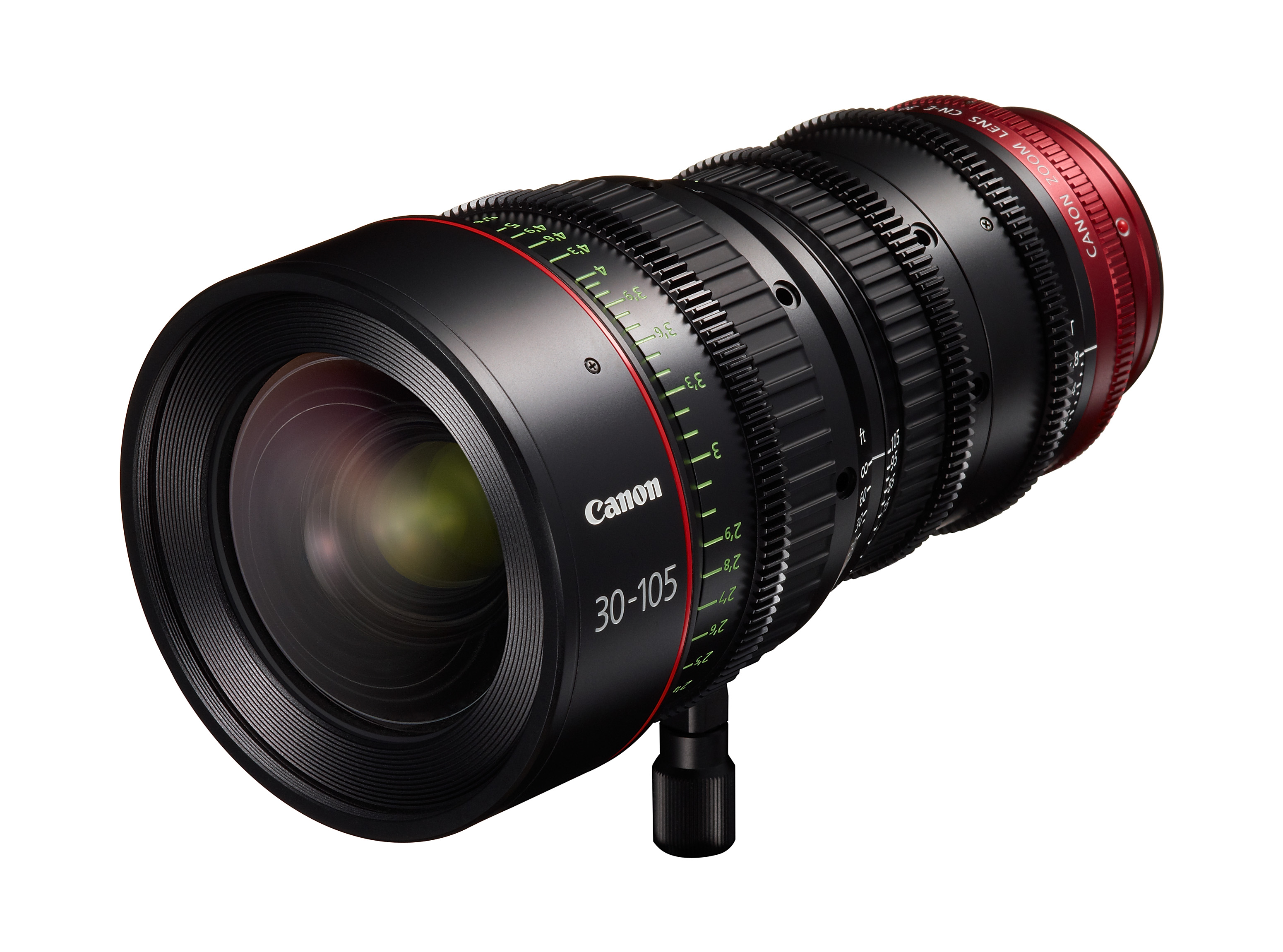

The two Compact Zooms are smaller, weigh less and cost less than the larger cine zooms. The 15.5-47mm wide zoom and 30-105mm telephoto zoom are matched in terms of width and length, allowing the focus, zoom and iris rings to be co-located. Both are constant aperture T2.8 with an 11-blade iris. They share the same front diameter and filter threads as the Canon cine primes, allowing greater flexibility when choosing a matte box or screw-in filters. Available in either EF or PL mount.
Canon Compact Zooms (S35 4K)
15.5-47_slant 30-105_slant
CN-E15.5-47mm T2.8 L S
CN-E15.5-47mm T2.8 L SP
(12.2012)   ⌀114/⌀105   MOD 0.5m   2.2kg   ~$23,500
CN-E30-105mm T2.8 L S
CN-E30-105mm T2.8 L SP
(10.2012)   ⌀114/⌀105   MOD 0.6m   2.2kg   ~$23,500

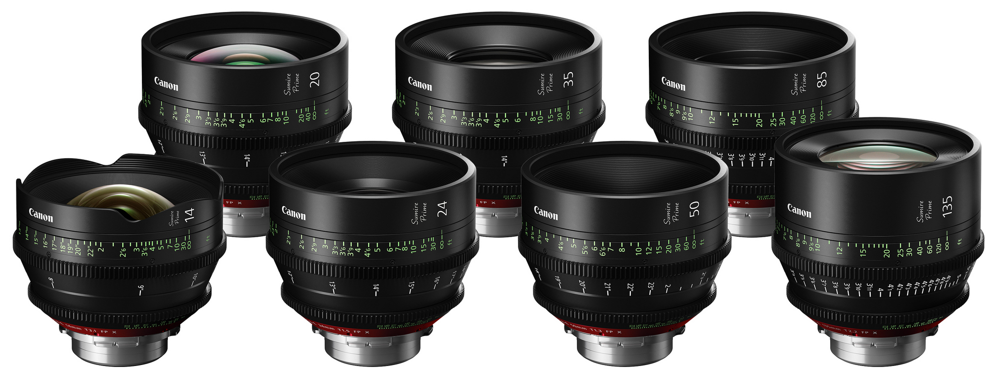

The seven PL Sumire Primes have a great deal of features and specifications in common with their EF Cine Prime counterparts, but the difference goes beyond the lens mount. There is a subtle but significant difference in the Sumire’s spherical aberration which affects the amount and quality of micro-contrast in the image. To quote Canon, it is “a nuanced look as the lens aperture approaches its maximum setting. This subtly modifies the textural rendering of actors’ closeups. It also smooths the transition from areas that are in focus to out of focus regions of the image, with gentle fall-off and pleasing bokehs.” The PL mount may be changed to EF (with corresponding lens data) by Canon service (and can be changed back to PL again if needed).
Canon Sumire Primes (FF 4K)
set_singleFocus
CN-E14mm T3.1 FP X
(4.2019)   ⌀114/⌀–   MOD 0.2m   1.2kg   ~$7,450
PL   available at B&H
CN-E20mm T1.5 FP X
(4.2019)   ⌀114/⌀105   MOD 0.3m   1.2kg   ~7,450
PL   available at B&H
CN-E24mm T1.5 FP X
(4.2019)   ⌀114/⌀105   MOD 0.3m   1.2kg   ~$5,250
PL   available at B&H
CN-E35mm T1.5 FP X
(4.2019)   ⌀114/⌀105   MOD 0.3m   1.1kg   ~$7,450
PL   available at B&H
CN-E50mm T1.3 FP X
(4.2019)   ⌀114/⌀105   MOD 0.45m   1.1kg   ~$7,450
PL   available at B&H
CN-E85mm T1.3 FP X
(4.2019)   ⌀114/⌀105   MOD 0.95m   1.3kg   ~$7,450
PL   available at B&H
CN-E135mm T2.2 FP X
(4.2019)   ⌀114/⌀105   MOD 1m   1.4kg   ~$7,450
PL   available at B&H

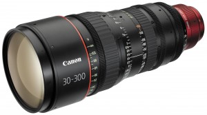

The large Cinema Zooms resolve at greater than 4K resolution. The 14.5-60mm wide zoom and 30-300mm telephoto zoom offer a very useful overlap from 30mm to 60mm when used together on A & B camera setups. The wide zoom has a constant aperture of T2.6 while the telephoto zoom has a slower, variable aperture. Both have an 11-blade iris. Both have the same front diameter for sharing a matte box. They are not threaded for screw-in filters. Available in EF or PL mount.
Canon Cine Zooms (S35 4K+)
Canon_6141B002_CN_E_14_5_60mm_T2_6_L_839223 Canon_6142B001_CN_E_30_300mm_T2_95_3_7_L_839228
CN-E14.5-60mm T2.6 L S
CN-E14.5-60mm T2.6 L SP
(4.2012)   ⌀136/⌀–   MOD 0.7m   4.5kg   ~$43,000
CN-E30-300mm T2.95-3.7 L S
CN-E30-300mm T2.95-3.7 L SP
(3.2012)   ⌀136/⌀–   MOD 1.5m   5.8kg   ~$45,000
EF available at B&H    PL available at B&H EF available at B&H    PL available at B&H
