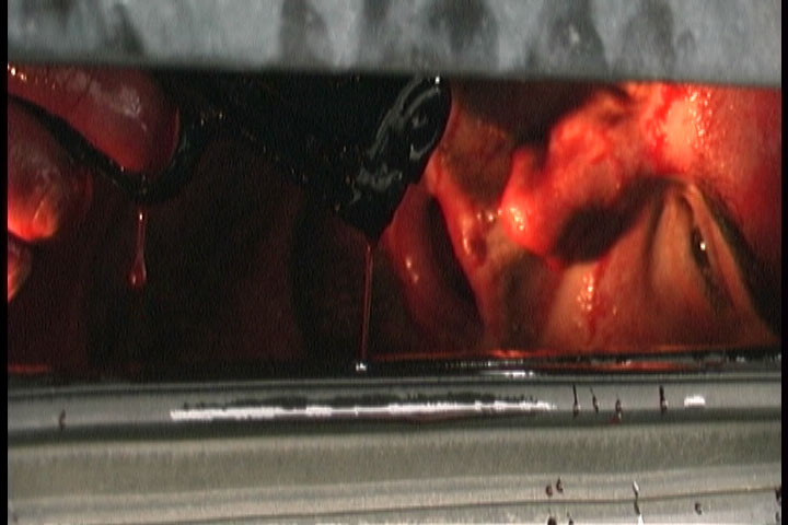

i've asked this once before, but i have to bring it up once more.
notice the lines in this frame grab, i cant get rid of them.
i dont know if it's happening on capture or what.
i am about to prepare for my cut and ingest all of this stuff for my flick and i obviously cant have these lines.
i've tried to export to tape and see if the lines would disappear on a standard tv but they are still visible.
anyone have any thoughts on this?
thanks in advance.

Are you talking about the black bars on the sides?

yeah, sorry.
any clue?
i've been using premiere for a long time and never had this problem.
feeling stupid....

I would simply increase my horizontal width.
