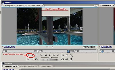

Double click the clip in the Project bin. It should appear in the Preview (left) window. Play or shuttle to the start point of the part you want to use. Hit the key 'i' (for "in" point) and a marker will appear in the preview window timeline. Play or shuttle to the end of that point (this doesn't have to be exact) and hit 'o' (for "out" point). Now, click and drag from the preview window video to the timeline. That section you just marked in and out will appear in your timeline. You can make adjustments to the length all you want afterwards in the timeline by "compressing" them.
This doesn't just apply for "long" clips, but for editing in general.
Your way works, but is bulky and generally doesn't work for most projects where there just isn't enough room on the timeline to use it as your "cutting board." The generally accepted workflow is cut up a clip in the preview window, adjust on the timeline.
